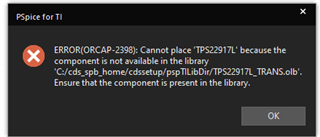

TPS22917L Pspice simulation: TPS61093: how do i correctly add TPS61094_TRANS to pspice for TI ?

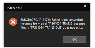

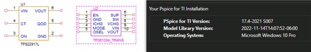

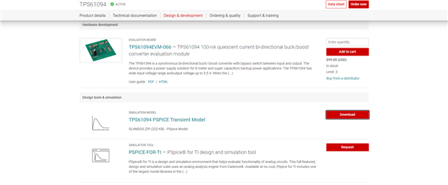

somehow the model for TPS61094 is not added correctly to pspice for TI.

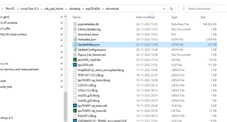

I tried to download the encrypted model and add to pspice for TI placing the file in the folder cds_spb_home\cdssetup\pspTILibDir
I can see the part name but the path seems wrong and i get an error
ORCAP-2472 failed to place symbol instance for model TPS61094_TRANS because library "TPS61904_TRANS.olb" does not exist ..

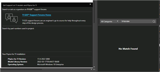

I also have ssue with  tps63900 which is no where to be found in pspice for tI either .

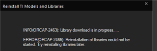

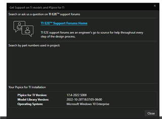

help --> reinstall models and lib does not make a difference

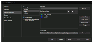

  • Hi Thomas,
     Maybe you can go to simulation settings to change library path manually, Simulation settings -> Configuration Files -> Library.

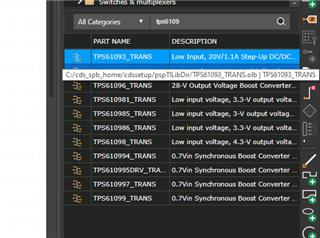

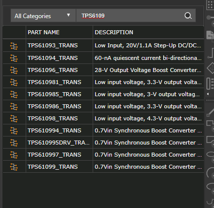

  • should it be possible to find TPS61094 or tps63900 in the default pspice for TI installation ?
    If i search for "TPS6109", i get the following

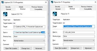

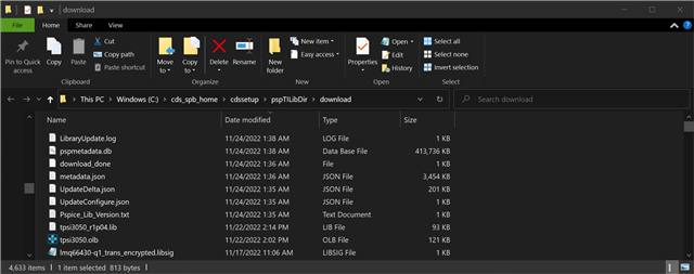

  • My library path includes the following :
    "C:\Cadence\PSpiceTI\tools\PSpice\Library";"C:\cds_spb_home\cdssetup\pspTILibDir"

    Are these 2 parts (TPS61094 and TPS63900 ) not part of the default TI library in pspice for TI ?
  • Hi Thomas,
    I am not sure if these 2 parts are in the default TI library, but the model you download in the device page (as I said in last reply) should be no problem. And more, we recommend that it'd better to use these model in PSpice for TI you can find the tutorial of Pspice for TI by this link.

  • i also had an error message when try to import the TPS22917L
  • Hi Thomas,
    This device is belong to PSIL-PS team, I have assigned this thread to that team.
    Nathan

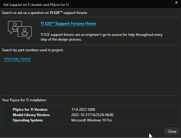

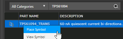

  • Hi Thomas,
    Please check your library version. Mine is 10-31:
    With this, I was able to place the TPS61094 symbol:
    I was also able to open TPS63900 test circuit:
    Note that help --> reinstall models and lib revert to the earliest version of the library, not the latest. You need to accept the subsequent library update prompt.
    -JC
  • PSpice for TI Version:
    17.4-2022 S008
    Model Library Version:
    2022-10-28T18:37:05-06:00
    Operating System:
    Microsoft Windows 10 Enterprise
    I have tried to reinstall the models and lib several time already (using help --> reinstall TI models and lib), but something must be choking in the process regarding the library and priority path. I just can't pin point what it is.
  • Again, do not use help --> reinstall TI models and lib if you need the latest models. This is for troubleshooting and It reverts to the earliest version of the library which does not have the newer models.
    10-28 is quite new. what is still missing?

  • i have updated the library to 2022-03-17T05:44:57-06:00 and TPS22917L symbols is now showing correctly
    TPS61904 & TPS63900 have been removed and don t show up any more.

  • i am working from company network but when i check with your colleague last time, there was no clear explanation which site i could not access
  • would you please check if you have this file?
    "C:\cds_spb_home\cdssetup\pspTILibDir\download\LibraryUpdate.log"
    -JC
  • content for this file is [2022_November_24_09_18_08] [SUCCESS] - Library Update Started.
  • [2022_November_24_09_18_08] [SUCCESS] - Library Update Started.
    [2022_November_24_09_22_16] [SUCCESS] - Library Update Success: Deleted All Components Successfully.
    [2022_November_24_09_22_35] [SUCCESS] - Library Update Success: Uploaded All Components to DB Successfully.
  • then i closed pspice for TI and restarted
    [2022_November_24_09_38_57] [SUCCESS] - Library Update Started.
  • [2022_November_24_09_38_57] [SUCCESS] - Library Update Started.
    [2022_November_24_09_40_50] [SUCCESS] - Library Update Success: Deleted All Components Successfully.
    [2022_November_24_09_41_00] [SUCCESS] - Library Update Success: Uploaded All Components to DB Successfully.
  • cadence full install and pspice for TI install on my pc
  • 2022-11-22T15:59:02-06:00
    file from C:\cds_spb_home\cdssetup\pspTILibDir\download\, the version is 11-22
    .. but in pspice for TI i have 2022-03-17T05:44:57-06:00
  • Hi Thomas,
    Please wait till the download folder is fully populated before running PSpice for TI:
    -JC
  • before i start pspice for TI the folder looks similar to yours :
    The version indicated in the log file Pspice_Lib_Version is " 2022-11-22T15:59:02-06:00" .. but when i start pspice for TI the version in pspice for TI is still 2022-03-17T05:44:57-06:00 and looking at the file in the path "C:\cds_spb_home\cdssetup\pspTILibDir\download" it looks like all files gets updated again but without any change on pspice for TI ... I let pspsice for TI running in the back ground for a while to see if it makes any difference somehow.
    One of the file which looks strange is the "UpdateConfigure.json" ..  the versions in that files are 2 years old and don't change
    { "MM": "1",
    "Library_Update": "2020-06-13T03:45:49-06:00",
    "Library_Force": "2020-09-09T14:14:10-06:00"
  • After a few minutes the folder stabilise and activity stops
    In the library log "LibraryUpdate.log" i get
    [2022_November_25_07_48_22] [SUCCESS] - Library Update Started.
    [2022_November_25_07_51_02] [SUCCESS] - Library Update Success: Deleted All Components Successfully.
    [2022_November_25_07_51_15] [SUCCESS] - Library Update Success: Uploaded All Components to DB Successfully.
    [2022_November_25_07_55_25] [SUCCESS] - Processed Library Count=1610
    [2022_November_25_07_55_51] [SUCCESS] - Library to JSON Success
    [2022_November_25_07_55_51] [SUCCESS] - Library Update Success: Closing DB Successfully.
    [2022_November_25_07_55_51] [SUCCESS] - Library Updated Successfully.
    Not change to the the version in pspice for TI which is still 2022-03-17T05:44:57-06:00 though
  • the library finally got updated :)
