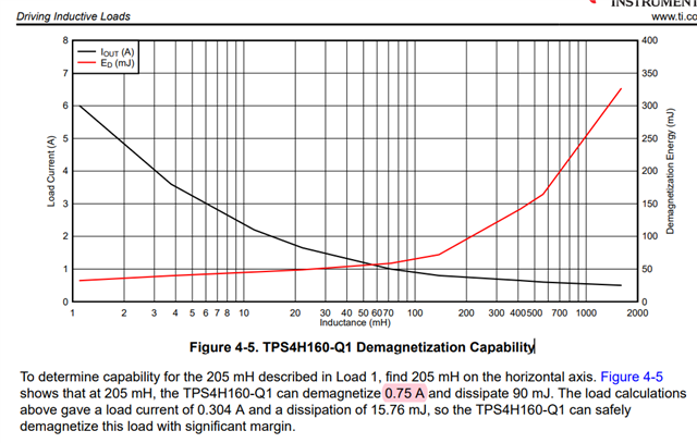

Hi Expert,
I have a confusion about Demagnetization Capability curve.
1. How does below plot come from? It varies device by device. Do we test and draw it, or get it by simulation?
2. I don't really understand why Demagnetization energy varied with inductor values. I assume all the Ed is dissipated on Rdson. Then the Demagnetization energy should be quite steady instead of varying with inductor so much. How do we get the max load current and max Demagnetization energy value? Thanks.
