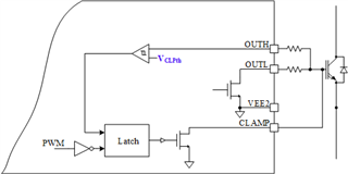

Figure 7-13 in the datasheet shows the CLAMP pin unconnected, should the wire running to the VEE2 pin go to the CLAMP pin instead?
(datasheet was accessed from https://www.ti.com/product/UCC5870-Q1 on 2022 Oct 25 and say "REVISED SEPTEMBER 2021")

Nicholas,
Thanks for pointing this out. Yes, the CLAMP pin should be connected to the gate. I have included a corrected diagram here.
We will work to get this corrected, and I apologise for any confusion.
