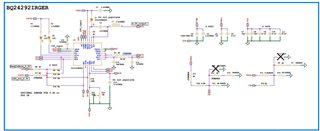

BQ24292I: Battery is not charging and STAT led Fully on
Part Number: BQ24292I
Other Parts Discussed in Thread: BQSTUDIO, EV2400
Dear TI Team,
I have finished the BQ24292i IC-based battery charger PCB for the IS,2P,6000 mAh Li-ion battery. I designed my battery charger schematic using the User's Guide SLUUA14C schematic after making some changes. I received the necessary output of the minimum system voltage at the SYS pin for various VBUS voltages (From 5V-15V). However, even though I have the CE/ pin grounded for charging, my battery is not charging, and the STAT lit is ON. The STAT pin LED is not flashing either (which means no Fault condition). Please support me to resolving the battery-charging issue.
Thank you
With Best Regards.
Muhammed Rafi C K
