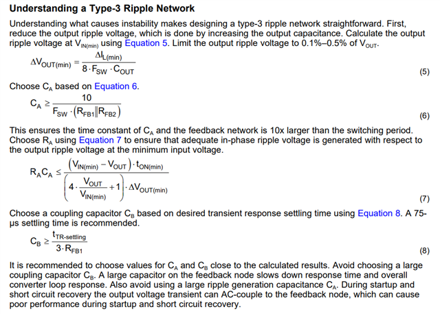

When I use LM5017, the following article is referenced to design FB ripple and Tpye 3 network is used. But I don't know how formula (8) and formula (10) in page 7 are derived and why CA and CB are designed like this.

    I'm afraid I stil couldn't understand how to get formula (6)(7)(8).
    In (6), I can't understand why the time constant is only related to RFB1//RFB2 and CA, but irrelavant to RA and CB?
    In (7), what the means of (4*VOUT/VIN(min)+1)?
    In (8), what factors influece tTR-settling? Since RFB1 is parralleled to RFB2 in small signal analysis, why tTR-settling is only related to RFB1?
    Could you please tell me the detailed derivation process of (6)(7)(8)?
