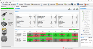

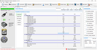

Hello Team,
                   So we connected the BQ34Z100 to EV2400. It was sealed and we unsealed it. When we try to write to registers we get
Also another thing we noticed is that when we power off and power on the device it goes back to the sealed mode. We then again unseal it and when we try to write to the registers it fails again.
The error is "a read of data written failed comparison"
We got this file saying some error had occured when we closed bqstudio
.4503.log.txt
Really need some help on this

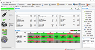

  • Hello Bhanu,
    bqStudio must read 3500mV on dashboard, otherwise something else may be causing the gauge to think that the voltage is low.
    You can program the default srec to "factory reset" the device but you will need to resolve this problem in order to be able to do that.
    Can you send a screenshot of the dashboard?
  • Hello Shirish,
    The dashboard is reading 3500mV.
    Flash update ok cell voltage is 2800mV
    So I dont know why we are unable to change the register values
    We cant change anything and this is really a big issue .
  • Hello Bhanu,
    The gauge defaults to 1 series cell configuration - so you would have to program the SREC or change the value of num series cells manually before the gauge would get to this state that cannot update flash. Before programming with the high number of series cells you should make sure that the configuration is correct, or set the Flash Update OK Cell Volt to 0mV during testing and only change it to the value desired (if any) during production.
    You can get out of this state by using another gauge or EVM and configuring the Flash Update OK Cell Volt to 0mV and export the SREC, then flash it to this gauge, the one you can't upload anything to (in FW mode).

  • Hello Wyatt,
                          Thanks for the information. So I programmed the SREC file to the gauge but I was not able to execute the FW. But somehow, I got out and was able to write to the Data registers after programming the SREC file to the gauge. Strange
