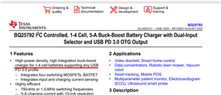

USB-PD-CHG-EVM-01Integrated USB Type-C® Power Delivery (PD) and charging reference design for 2-4 cell batteries EVM,Can the USB-PD-CHG-EVM-01 scheme charge a single 4.2V battery?

My schematic review of BQ25792 is as follows:
1. We recommend 3x pieces of 10uF and 1x piece of 0.1 uF on PMID.
2. What is the PROG pin connected to? Please follow table 9-1 in the BQ25792 datasheet for 1s configuration and proper switching frequency with inductor.
3. We recommend 5x pieces of 10uF and 1x piece of 0.1 uF on SYS.
I will turn it over to my PD counterpart to review the TPS25750.
