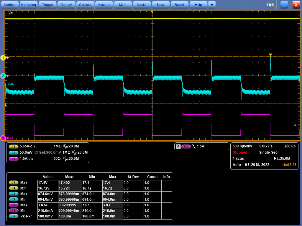

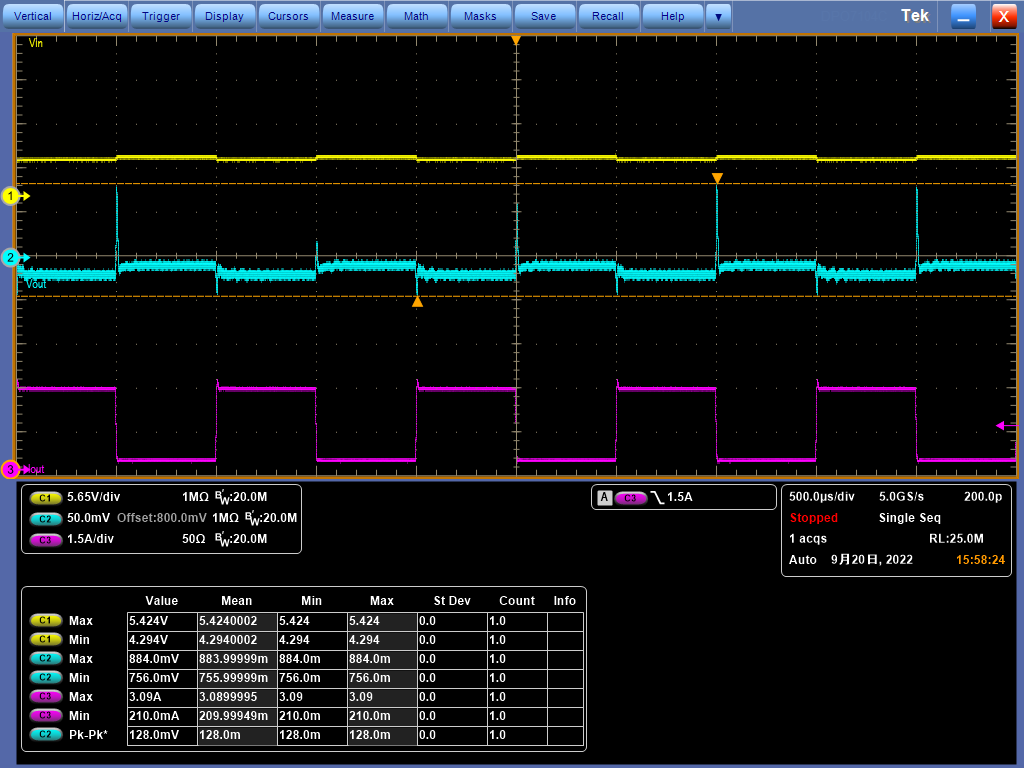

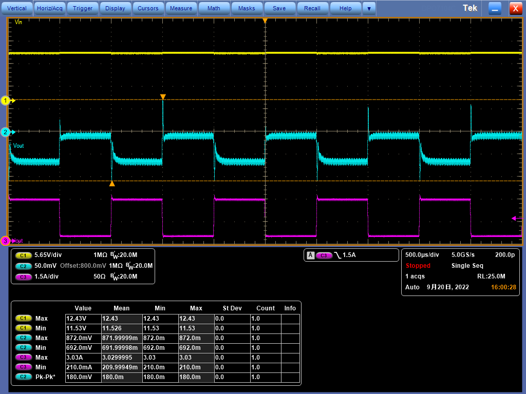

Hi team,

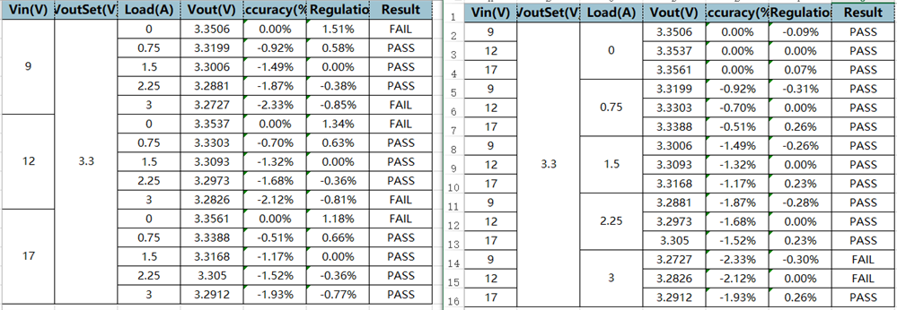

My customer wants a buck and I recommended TPS653201. But after test, it fails in output voltage and current accuracy as well as line transient. They need a buck that has <2% accuracy. And I wonder if TPS653200 is suitable. The test conditions and results of TPS653201 are attached below.
The following pictures are waveform of load transient. They need <5% overshoot and undershoot.
