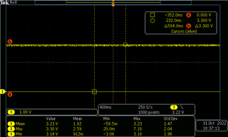

I have two boards with the same application and circuit, but In the firts board I have the partnumber TPS22965, and in another hand I have TPS22965N.
In the board wen I have the partnumber TPS22965N I have this response in the 3V3 Rail,

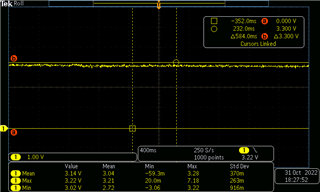

And the other board with I have the partnumber TPS22965, I have this response in 3V3 rail, it's like a mean of the power supply changed, it's not 3V3 but 3V14, and when I started a supply the circuit, the 3v3 it's floating.

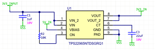

The schematic Its in bellow:
