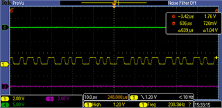

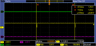

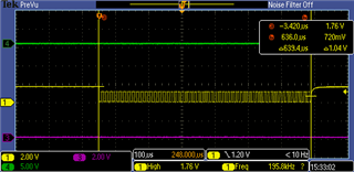

There seems to be some sort of negotiation happening when I probe the right CC line the storage device is attached to. But it looks like a repeat of the same signal that lasts ~15 seconds before it gives up and remains pulled up to about ~1.7V.
Each burst of data happens every ~170ms for ~15 seconds until it gives up.
This doesn't appear to happen on the TPS chip connected to the Tablet. Complete negotiation seems to happen in less than a second and starts to see all the downstream ports instantly (besides the type c downstream port of course)
