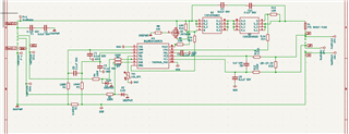

I attached the schematic. In the discharge mode,  we can not get above 3.5A current with BMS, but  we can get 8A current output from the battery cell without BMS. How can we increase the discharge current output to 8A with BMS? Could you help us?

    The short circuit protection is probably being activated. This can be set in data  memory. You should also look at the FET capabilities before increasing the limits

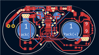

    Can you share your gg file? Also, can you share your layout?

  • Hello Jose, we turned off all protections as shown in below figure. OCP stands for over current protection. SCP stands for short circuit protection. Although it is set to 6000mA by default, we cannot get output over 3.5A.
    I attached the layout picture of the project and gg file.
