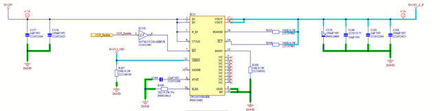

TPS16530 - Voltage observed at output
We have TPS16530 as load switch to power up external peripheral.
Power to this device is dual powered (Battery and DC Supply) and when device is in shutdown mode (no supply, but battery alone is connected not powered), still I observe voltage of 110mV at the output.
EN and SHDN pin control signals are active only during DC Supply.
I'm trying to understand and find leakage path here which is making 110mV at output. Could you suggest possible way to avoid this?
