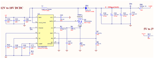

Hi Team
There is good news that we DIN LM5156-Q1 again!
Please help confirm the design is good! THX
1.Vin is 12V
2.Vo is 18V
3.Io is 2.5A

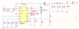

4. Now C69 change to 1500pF. R5 change to 10ohm.
Hi Stefan
Thank you for the feedback!
Please help confirm the design ,THX
1. The Vin is 12V and Vo is 18V !!! (It's mean 12V boost to 18V)
2. What is 4. referring too ? I might miss the history.
--> No history here , the below SCH have changed some parameter value of the element now .(The change is "R5 change to 10ohm" But the SCH has not changed yet)

Hi Kygo,
some feedback on the Schematic:
- Inductor might be too small from the current rating, peak inductor current is 5.24 A. Please consider this (plus some margin) for saturation current rating of the inductor. Wenn considering the max current limited by the sense resistor the peak current can go up to 10A)
- compensation and loop stability does not look OK. Changing R11 to 2.5k looks much better
You can also check this with the Quickstart calculator which can be found on the product page.
