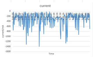

We have 2S pack which use BQ28Z610-R1,the actual discharge current is as below figure,how to choose the load mode to avoid SOC Jump?
We had set load mode=0,load select=1  but SOC JUMP 21% to 0%.
  • Hello Ran,
    A load select value of 7 will give better results. If you want the battery to handle a  -1400mA load at 1% you can set load select to 6 and program the user rate to -1400mA. Setting this higher load will result in longer run time at 0% with lower loads.
