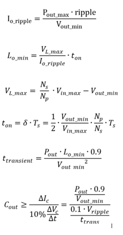

I am using UCC28951 to design a 2.4KW (400 V to 12 V) DC DC converter that charges a battery.
My application has a ripple current for the capacitor of around 11 A. The frequency of the ripple current is 200 kHz.
Since my load is a battery I don't have the same requirements as the ones mentioned in the application note for sizing the output capacitor.
Can I base the selection of the output capacitors on their ability to handle the ripple current alone. I mean for example connecting 10 10uF MLCCs like this one here
www.murata.com/.../productdetail
Will that low value of the capacitance cause problems? Will the very low ESR of the MLCCs cause stability problems?
