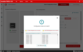

1. Are these bin files "correct"? Or TI has some update about them?
   We found that NVM setting of Bin Files are quite different to NVM setting read back from TDA4VE EVM & TDA4VM System Board. You can find the diff file in attachment.
  • How can I confirm Bin Files are good?
  • Which file is the 1st choice to reprogram? Bin Files from local Sales team or Bin Files read back EVM?

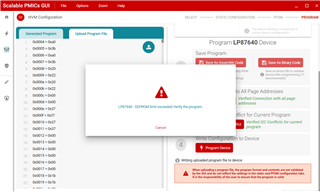

2. How to fix the issue EEPROM Unlock Fail issue?
   We reprogramed 1212 to 1120 in TDA4VM System Board and selected not to lock EEPROM in the last step, then read back to verify. Both Bin File from local Sales team or read back from EVM works good.
but, when we solder the chip on  TDA4VE System Board, we met the EEPROM Unlock Fail issue.
GUI shows that I2C Address 0x48 connected, but it is unable to read the register. And when we scan the PIMC, GUI can only find 2 of them (0x4C from 1421 and 0x58 from 11A5)
PS: We changed the I2C Address of Hera from 0x4C to 0x58 for address conflict issue.
  • What‘s the reason for EEPROM Unlock Fail issue? Are some thing I need to check on TDA4VE System Board.

  • Hi Kim Yang,
    1. It looks like those are the most recent revisions for the files.
