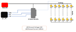

Hi Team,
Can you please help select the proper LED driver for the input below?
Vbat=24V, (If=100mA, Vf=2,9V each LED) 6x8 or 8x6 LED string
I hope you can help.

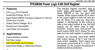

Thank you for the help. I have a follow-up question,
Can they also use 8 Bit-Shift-Register TPIC6B595 if the current (100mA) has to remain constant in each string?
I hope you can help further.
Marvin

Hi Patrick,
I saw in the datasheet this
So I just like to confirm if it is possible.
Marvin
Hi Marvin,
Yes, this device can also be used with customer design.
BR
Patrick
