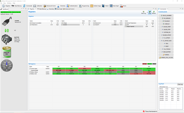

I have the bq35100EVM board connected to the EV2400 and started BQstudio.  I updated the Configuration Operation Config A to set EOS mode with GMSEL1 = 1 and GMSEL0 = 0.  I updated battery chemistry to ID = 0608 which is what I have (Li-SOCl2 (LTC), 3.6V, 19000 mAh).  The bq35100EVM has the Bat+ and Bat- connected to my single cell LTC battery.  I also have a connector for the load with Bat+ to Load+ and Pack- to Load -.  The bq35100EVM has a jumper in the GE_PULL-UP and ALERT/PULL_UP.  S1, S1 have jumpers on them.  For J3, I leave the jumper on 2S since it probably doesn't matter due to not using the 2-4S selection.
*Note: my LTC battery is not new and it's probably about 80% depleted and that's what I want to be able to check with the EOS mode.
I followed the procedure from another post someone talked about measuring the LTC here:
1) Power bq35100EVM to get GE enabled by putting in the battery.  Check that BQStudio sees the bq35100 with no issue

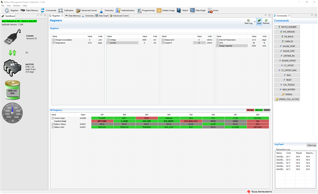

2) Plug the load in with the connector.  I can see it's drawing -17 mA on average.   Check that EOS_BAD_OCV and GA are both still green.  I click the GAUGE_START button in BQStudio.
     - At this point, I see the EOS_BAD_OCV and GA turned red.   (I don't know whether this is good or not.)
3) I unplug the load and let the battery relax for a minute or so then send the GAUGE_STOP.  Wait a few seconds for the status update.
4)  I see the impedance calculated as 7.341 ohms.  The SOH is updated to 90% but I don't know whether that's right.
Am I doing this correctly?   Do I need to do this first with a fresh new battery?  Why does the design capacity stay at 2200 mAh even though the chosen battery chemistry ID 0608 should have given it 19000 mAh.

  • Hello Patrick,
    You need to start with a fresh battery, Design capacity needs to be set separately from battery chemistry since the same chemistry cells can be placed to parallel for gauging with  bq35100
  • OK, I'll get a brand new battery and run this through again.  How do I measure the capacity of the near-depleted one after I got the new one measured?
  • Hello Patrick,
    The bq35100 expects a new battery and tracks the capacity of a single battery. Connecting a depleted battery is not expected.
    You may be able to get capacity of a depleted battery after running a few cycles as per the Battery Gauging modes. For EOS mode see TRM section 5.3.2 End-Of-Service Detection
