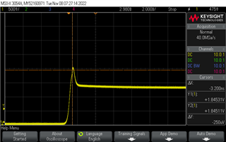

    Here is a snapshot of Vcc node during startup:
  • Hi Petr,
    That VCC is strange, it doesn't even make it to 5V before falling off.

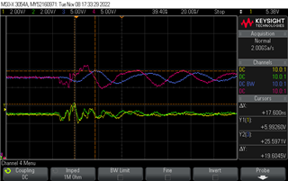

    I aimed on AEFVDDA and VCC. During hotplug, there seems to be some transient actually exceeding the pin rating on some occasions. I will tomorrow doublecheck that this is scope related issue but attaching the snapsot anyway if it would ring some bells.
    Magenta-supply connector
    Blue - chip Vin (after 3.3uH inductor)
    Green - Vcc
    Yellow - AEFVDDA
    This is during unplug event, afterwards Vin starts to fall. I looked there as well, but nothing suspisious there after these events.
  • Hi Petr,
    That waveform is different from the previous VCC wavefome.
    Will you be able to get a scopeshot of the startup or issue?
    Let me check with the designer, I see we have AEFVDDA pin max as 5.5V, however the VCC absmax is 6.5V so I would expect AEFVDDA to be tolerant to 6V.

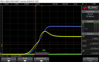

    Here is a picture from a dead board during power-up requested earlier. To your question - the output is not regulated.
    Yellow - Vcc
    Green - CNFG
    Magenta - PGOOD
    Blue - Vin
    (mind the different voltage scale, the Vcc does not actuaslly power up before Vin)
  • Hi Petr,
    That dead board looks like the VCC is not coming up to 5V.  I'm assuming removing the AEFVDDA resistor will allow this VCC to reach to 5V?
    The configuration time seems a bit long but it does seem like it is working.
    The PG is not coming up so the AEF should not be enabled, I'm not sure why the AEF would be consuming current.

    Any idea about that Vcc overshooting nominal value during unplug in the scope shot I posted before?
    Engineering sample run date is approaching and we would like to have some understanding of possible sources. It is ok to take the discussion into PMs or email if some IP is involved.
    Many thanks
  • Hi Petr,
    Based on the top marking the silicon revisions are the same.
    I tested a hotplug on the EVM, the VIN does not ring like that.

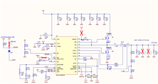

    I cannot see your AEF inductor, however from your schematic it does not appear as if your filter is damped on the power stage side.
    For any LC there should be damping to prevent ringing or resonances.
    We used CD and RD for this damping. See section 9.1.1.5 in the datasheet.
    See appnote as well: https://www.ti.com/lit/an/snva538/snva538.pdf
    I did talk with Systems, the AEFVDDA absmax is 5.5V and not tolerant to higher VCC.
    I suspect that VCC ringing did damage the AEF circuit (which is separate from the controller).
    We are not sure why some ICs are more tolerant than others, but that VCC is not acceptable for AEF.
    I will add a note to the AEFVDDA about potential clamping needed.
    However if your VIN is properly damped then VIN and VCC should not ring as such.
