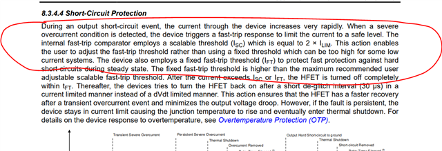

Please tell me the value of Ift.
Nishie
Hi Kunal-san,
Thank you for your reply.
I didn’t be able to find the value of Ift in datasheet.
I would appreciate it if you could tell me.
Nishie

Hi Kunal Goel-san,
I received additional questions from a customer, so could you support me?
There are Isc and Ift for overcurrent detection during steady-state, how do you use them?
Why are there two kinds?
Nishie
Hi Nishie,
Please refer this note:
Also for example consider the case in which someone selects RILIM resistor out of recommended range which will set ILIM and 2*ILIM out of range. In that case fixed threshold acts as a second layer of protection.
Kunal Goel
