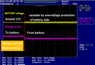

Our customer are evaluating TPS25750 and BQ25792 on their board.
(Their board is almost the same circuit as USB-PD-CHG-EVM-01.)
Then, BQ25792 charging current does not stop at the battery charging voltage(setting voltage is 16.8V).
At the result, battery voltage rises to around 17V and unstable by overvoltage protection of battery side.
Could you please let us know the cause and workaround if you have any information?
By the way, if REG0A VRECHG_3:0 value was changed from 200mA to 800mA, the occurrence frequency decreased(so there was a change).
<Detail information>
-TPS25750 is UFP only
-USB PD adapter is 20V/2.25A
-Load current of SYS pin is around 1.7A
-Battery is charging from 95% to 100%
-Occurrence is low (Once in five times)
-bin file is “7723_Config.bin” (file provided from you)
<Waveform>
