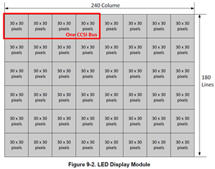

    I can see 9.2.1.2 . But I'm confused about x4 in "V_Data is 30 × 32 × 48 bits × 4 "
    and 0.8 in  "fSCLK = V_Data × fframe / 0.8
    could you give me more comments about this?

  • Hi JH,
    1. For "x4", it means there are four 30x30 matrices in one CCSI BUS. See below figure.
    2. For "0.8", it is an estimated data transmission efficiency due to the need to transmit extra bits like start bit, head-bytes, check bit, end-bytes, VSNYC command, etc.
