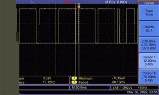

    According to Cell Balancing With BQ769x2 Battery Monitors (Rev. A) (ti.com)The device includes an internal die temperature check, to disable balancing if the die temperature exceeds a programmable threshold. Balancing is temporarily disabled during the regular measurement loop while the actively balanced cell is being measured by the ADC, as well as when the cells immediately adjacent to the active cell are being measured.
    While observing balancing on an oscilloscope, I can see a waveform that correlates with the above statement.
    Balancing off for 10 ms
    Balancing turning off every 63 ms

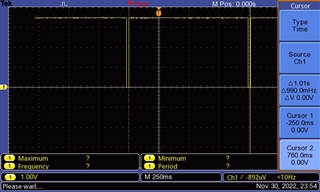

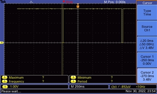

    But after approximately ~10s of keeping balancing ON, I see that the AFE stops turning balancing OFF for measurements. Balancing only turns off every 1 second (presumably for OCV CUV checks) Waveform captures attached below:
    Balancing off for 20 ms
    Balancing OFF every 1 second

    I send the balancing command every 500 ms from the MCU. We use external balancing resistors in our design. The waveforms captured are across the balancing resistors.
  • Hi Aman,
    I do not know your register settings, but is it possible the device is going into Sleep mode after 10 seconds which will reduce the frequency of cell voltage measurements? You can try to disable sleep mode (send the SLEEP_DISABLE() command) to see if this behavior changes.
    Can you share the schematic for your balancing circuit? Are you using the recommended cell input filter resistor and capacitor values? Larger filter components will have a longer settling time which could affect the voltage measurements.
    Matt
  • Hi Matt,
    Setting the SLEEP bit in Settings:Configuration:Power Config to 0 resolved the problem. Looks like the AFE was going to sleep after the default timer of 10 seconds.
