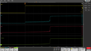

  • Hi Rakesh,
    This is  FAE support Musiu for this case in field and customer would like to know whether you could provide the formula Vgs of Q1 which should be related R1, Q1gs, Ipu , R2, C1.
    They would like to know the rising time of Vpu as below figure is reasonable. Thanks.
    Ben
  • Hi Ben,
    V(BST-SRC) is the voltage appears at the PU pin, which charges the GATE VG of Q1 with a time constant of R1C1. As it is a slow ramp-up, the MOSFET Q1 works as source follower with Vout = VG - Vgs_Q1
    The timing is decided by the equations (2) and (3)
