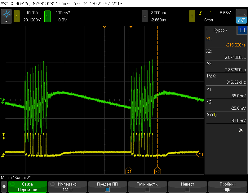

  • Hello!
    I have similar problem with TPS65251RHA.
    I am using TPS65251RHA to generate respectively 1.5V, 1.2V and 1.8V using DC/DC 1, 2 and 3. The board is powered at 9V to 15V. I have tested it at 12V.
    All components are like in evalution board. (with the exception of resistor dividers for feedback )
    At first all voltages and power consumption were ok.
    I was trying a sequence of turn-on and turn-off operations on a board without any load, with period of some seconds. Suddenly power consumption grews up and IC became very hot. It was error in 1.2V line.  Voltage ripple increased in this line. Look oscillogram: (green - output voltage, yellow - signal on LX2)
    I measured resistance between LX2 and GND, it was about 14 ohms. Resistance between LX1 or LX3 was greater 20kohms
    And now all three channel have failed. And this problem occurs on other boards.
    What is wrong? What must i do to solve this problem?
    We are going to use this PSU in our new products and it is very important to solve this problem!
    Thanks in advance
    Polukhin Alexander.
    P.S. Sorry for my bad english
  • Hi
    This is Wentao from TI china  Beijing R&D center.
     Nice to meet you.
    You can contact me if you have any issue in 251. I saw you weretrying a sequence of turn-on and turn-off operations on a board without any load. And I found that , your Switching frequency is nearly 5MHz from the waveform, Am I right? It seems very strange.
    Could you please tell me the detail of the  operations and you SCH? You can also send the detail to my Email: w-xie@ti.com.
    Thank you very much!
