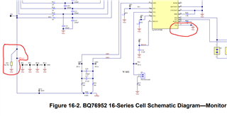

Hello
Is the BAT- net tied to the VSS net directly or across a 0-ohm Resistor/Ferrite bead, etc?

Hi Anvin,
It is connected directly. You may find this previous e2e post helpful: (+) BQ77905: 20 Series Schematic, Use of NET tie. - Power management forum - Power management - TI E2E support forums.
