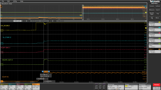

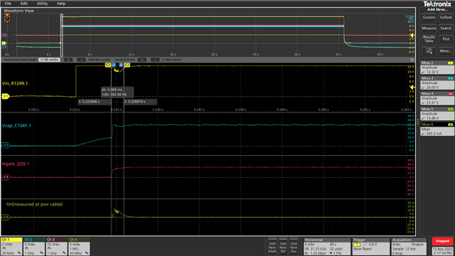

    Please see the Captured waveforms as requested.
    a. Vin, Vcap, HGATE, Iin
    b .Vin, VS, VCAP-VS, DGATE
    Chaitanya
  • Hi Chaitanya,
    From your waveforms, it is clear that the input voltage is dropping during startup. This is probably due to
    1. High impedance in between input power supply and the evaluation board (may be long cables)
    2. lack of input decoupling capacitance
    3. Current limit of the input power supply

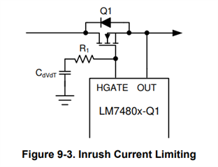

    To reduce the inrush current during startup, increase the Cdvdt capacitance to say 47nF or 100nF. For more understanding, please refer to section '9.3.2.2 Load Disconnect Switch Control (HGATE, OUT)' and '10.2.5 MOSFET Selection: Hot-Swap MOSFET Q2' of datasheet.

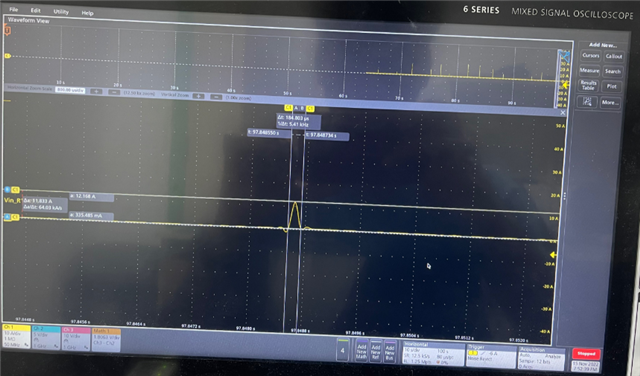

    i have added a quickly 100nf capacitor between HGATE and Ground and also at the startup i have disconnected the load and here is the input current waveform.
    We still see the around 8A pulse at startup of LM74800.

    As per your feedback we have done following changes in our custom application board
    1. Added a input capacitance of 100uf
    2. Modified the HGATE of LM74800 to 100 ohm + 100nf.
    3. Disconnected the load.
    4. Power supply we are using a 12V, 7Ah battery with shorter power cables.
    After above modifications we still see closely around 8A inrush current as below. Do you have any further feedback on this.
    I suspect Large load capacitance are contributing this sudden spikes at input current.
    Chaitanya

    As earlier, please share waveform captured with the following signals,
    1. Vin, Vcap, HGATE, Iin
    2. Vin, VS, VCAP-VS, DGATE
    In the schematics, I see only 0.6uF capacitance at the input. Is there any additional capacitance at the input which is not shown in the schematics ?
