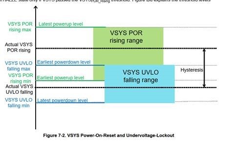

Team,
Figure 7-2 in the datasheet shows a graph about VSYS POR and UVLO range. But the exact max and min values are not given. Can you please provide them? This is for TPS6521902.

Hi Robert,
Thank you for using E2E! The table below shows the VSYS POR and UVLO spec. These parameters will be added to the final RTM datasheet. Please let us know if you need any additional information.
