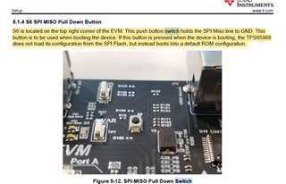

I want to understand the function of Push button on EVM board.
I need more detail about the function of each switch.
For S1, I have following questions.
  1. Why , we need a soft reset?
  2. Is there any circumsetences when we must need to reset the TPS65988 chip?
  3. Should i have it on mass production board?
For S6, , I have following questions.
  1. What is the purpose of booting the PD controller?
  2. Is there some specific configuration that must be load through booting process?
      1. A soft reset allows you to reload the patch without power cycling the device. You may not need a button on your own design, but this provides a way for hardware to trigger a signal that resets the device through the HRESET pin.
      1. This is case by case, there may be failures where a reset is the best choice.
      1. This is case by case and is up to you. If you think you need the button, leave it in. If you don't need the HRESET feature, the datasheet recommends grounding the pin.
      1. Booting from the SPI flash loads any updates and patches to firmware, as well as the configuration that you make in the configuration GUI
      1. The specific configuration depends on your use case and is configured through the GUI.
      1. You most likely do not need the switch unless you plan on using the default rom image.
