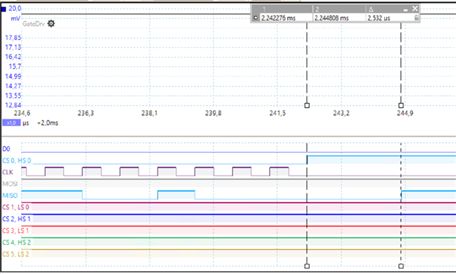

UCC5870-Q1: Synchronization issue for SPI lines.
Part Number: UCC5870-Q1
We are using the gate drivers in independent slave configuration.
Clock frequency 1 MHz.
We are facing some issue in synchronization of all 4 SPI lines. For instance, the MISO line is lagging from the Chip select pin by 2.5uS and for some commands the MOSI triggers before the clock pulses.
Synchronous SPI communication is used here.
