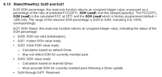

Hi team,
My customer is evaluating our BQ27426 for their battery system.

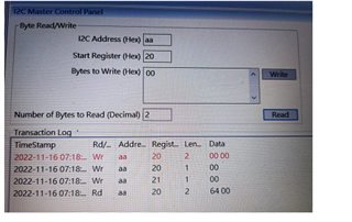

They  read the state of health value of 0x20,0x21 by BQstudio ass below figure.
The read back value is 64 and 00. According to document, customer think that 0x21 value is invalid if it is 0.
Hence, they would to confirm with you whether their understand is correct. If it is correct, is there reason to induce this invalid value? Calibration file?
Sorry I am not very familiar with our gauge and need your kindly comment about it.
