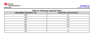

  • The EVM was designed to PWM dim at 100 Hz or higher, based on the bootstrap capacitor selection.  Increase the PWM frequency and you should be ok.  The bootstrap capacitor is getting discharged and then it hits BST UV and the LS fet is turned on the recharge it before starting switching.  The BST capacitor provide the supply for the HS driver, it is a floating driver.  There are limits to how high a value you can go with the bootstrap capacitor, because it can hit negative current limit if you go to really large capacitors.

    According to CBST calculation, increase the bootstrap Cap to 6uF, PWM operation can be at 30Hz, but is it recommended to use this way? (below 100Hz)

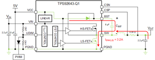

  • Hello Kygo,
    At very low PWM frequencies you need to be careful increasing the boot strap capacitor (CBST) between SW and BST.  If the CBST is too large then it can trigger the LS ILIM when you try to charge it.  The reason we generally recommend the larger values of CBST is that you want start switching as soon as UDIM goes high.  If the CBST is charged to above the BST UV threshold then it starts switching immediately.  If it is below the threshold then it turns off the LS FET to charge up CBST from VCC.  It won't turn on the HS fet until the CBST voltage is above the BST UV rising threshold.  That takes time to do, so that means you can get inaccuracies for the average output current based on the PWM  to average output current calculations.  Here is the current path to charging CBST.
    The instantaneous current can be high when using large CBST, thus it can hit LS ILIM.  The way around this is to use a much smaller CBST (on the order of 33nF) for lower PWM frequencies.  It will not start switching immediately, but the delay in charging up the CBST is much smaller and become insignificant when compared to the period of a low PWM frequency.
