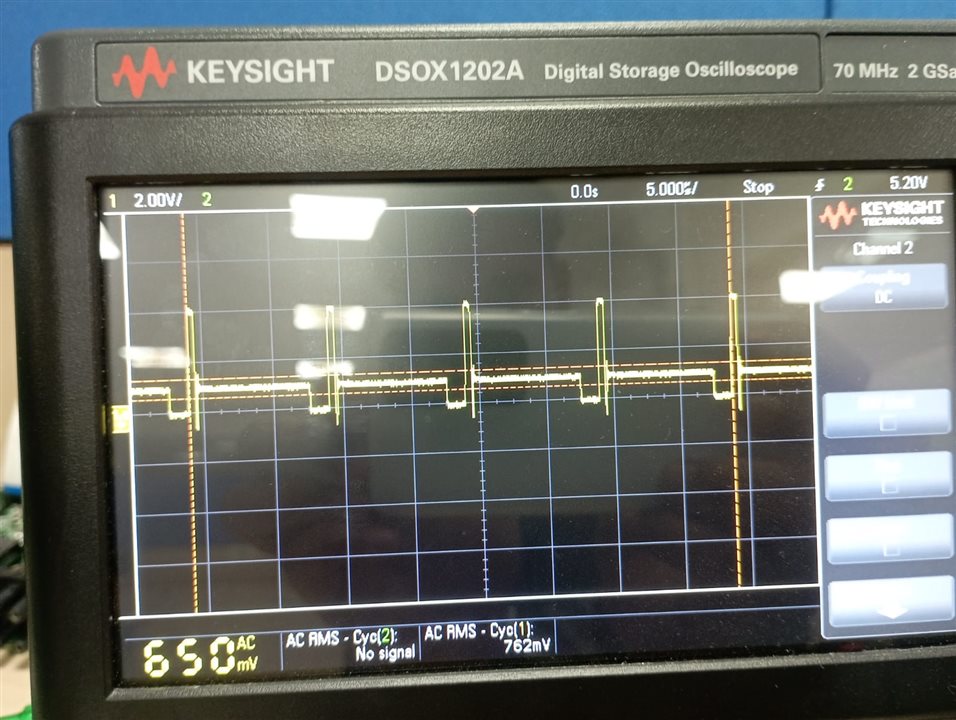

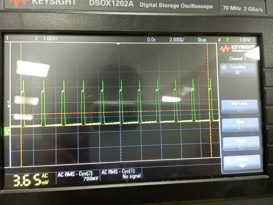

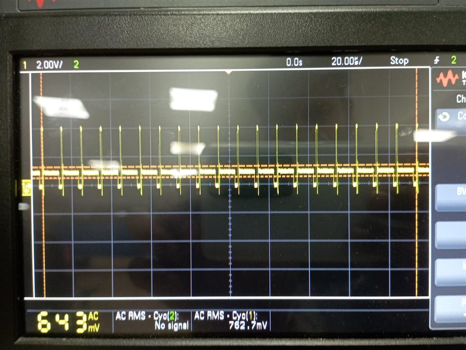

  • Nathan,
    Kindly find attached waveforms for switching node while working in boost mode.
  • First 2 waveforms are for boost mode operation & waveforms showing burst operation is in buck mode.
  • Hi Mitesh,
    Could you please provide the test condition in these 3 figure? And which one is the condition that "device  is drawing more than 2A current from super cap when super cap voltage > 2.0V" ? These three results is seemed to be normal.
    Nathan

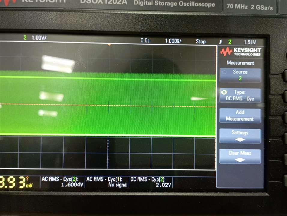

  • Nathan,
    Waveforms shown previously are with the lower voltage with which device is working fine but whenever voltage from super cap is above 2.0V device is start drawing  > 2A of current even if there is no load at output.
    customer has shared the waveform & you can see the duty cycle is very wide for no load condition.
    Mitesh
  • Hi Mitesh,
    It seems the device is triggered valley current limit (about 2A), so it can't regulate VOUT to target value. And this may because there is large load current although customer said there is no load but it would be better customer could double check this.
    And more, did customer try another chip? Did this problem appear each time? Or customer could also have a try in our EVM to see if there is a same problem.
    Thanks.
