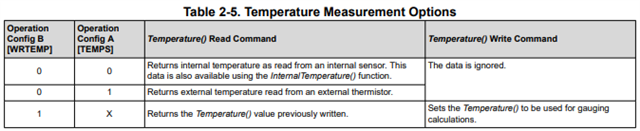

My customer would like to use BQ27220 with an external thermistor. However it doesn't go well. Could you please answer questions below?
[Situation]
(1) Measured digital value is about 2970.
(2) When the BIN pull-up resistor was changed from 1.8MΩ to 10kΩ, the analog voltage changed, but the digital value sent to the microcontroller hardly changed.
(3) The customer think the thermistor inside BQ27220 is enabled and the external thermistor isn't enabled from the result of (2).

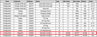

(4) The Technical Reference Manual (figure below) says that it is possible to measure temperature with an external thermistor by changing the value of Operation Config A.
[Questions]
(1) I can't find the description about the address of Operation Config A. I don't know how to change the value, so could you please let me know?
(2) As a pull-up resistor for BIN, they attached 1.8MΩ with reference to the data sheet and the circuit diagram of the evaluation board. Is the pull-up resistor value of 1.8MΩ correct when actually connecting an external thermistor?

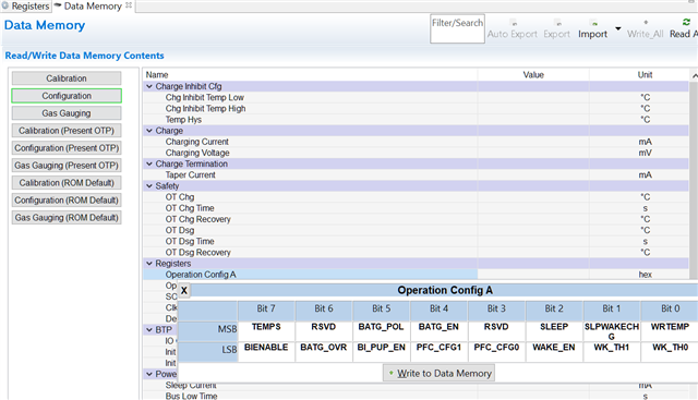

  • You can check, if the external thermistor is enabled by probing the thermistor pin on the gauge. If it's enabled, then the gauge will turn on an internal bias resistor (about 1.8kOhm) for a few ms every second during normal mode (not sleep) so the resulting voltage from the effective divider (thermistor to internal bias || external pullups) will be visible on a scope.
  • Operation Config A location in Data memory

  • For an example of how to read/write from MCU, See TRM section 6.1 Data Memory Parameter Update Example
  • Hi Shrish,
    Thank you for your comment.
    I had the customer follow the contents of Chapter 6 of the Technical Reference Manual, but it didn't work. Could you please tell me the procedure for changing from the internal thermistor to the external thermistor?
    They are performing I2C communication according to the instructions in Chapter 6, but it seems that sometimes the communication fails without an Ack being returned. Could you tell us if there are any restrictions such as time during I2C communication?

  • Did you write 0x04B0 to Operation Config? If yes, then all your original steps are correct. The checksum includes the data that is written (Your interpretation in Q4 is correct)
    Note that TEMPS bit would still be 0 if you write 0x04B0.
