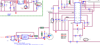

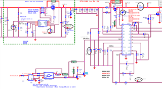

if customer want to change Q0273, do you have any recommend?

Please refer below,
We try to add the MOS to Q723 to control enable or disable LM5121 .
Hi Jimmy,
thank you - I found it now in the schematic.
You can of course use the one show in the schematic but there are no major requirements on this FET.
So should be easy to find another one. Is there a reason why not using this one?
