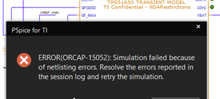

Hello Niranjan,
I have contacted internal team & will get back to you.
Travis
Hello Niranjan,
Its a parallel VID bus to simulate SVID behavior. It can sometimes be easier in simulation to use parallel instead of serial for VID transitions. These pins are for simulation test & debug only, and do not exist on the real part. You should be able to safely ignore them if you want to.
Travis
Hi, Thanks for your guide . I did same thing as you told but still there is error while i simulating this model for load of 10A and 4A at VNN_DCD1 and VCC_DCD0 respectively. So can you suggest how it resolve? for your reference i have attached schematic6153.PROBLEM.pdf and error displayed in simulation.
Hello Niranjan,
I'm going to reassign this thread to the PSPICE team to see if they can assist.
Travis
