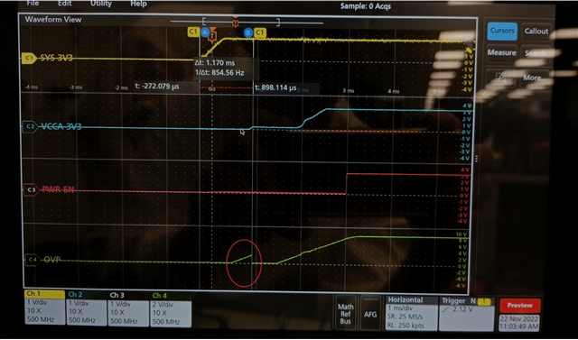

Would you help share your comments on OVPGDRV (tps65941212) behaviors when the Vsys_sense and VCCA reach 3.3V but Enable pin keep low during power up ?
Are the vsys monitor and OVPGDRV output controlled by Enable pin?

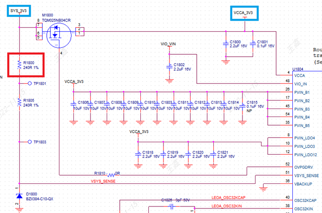

  • Hi Daniel
    Customer used tps65941212/1111 to provide the power supply to TDA4VM PDN-0B reference design.
    you can find the part of LeoA schematic for refernce.
    Below scope waveforms between Vsys_sense, OVPGDRV, Enable and VCCA.  Would you help share your comments how to remove the red marked pulse with cycle at OVPGDRV output waveform during start-up?  After the system powered up, the system worked normally and no unexpected intterrupts were found in regisister 0x5A-0x6C.
  • Hi Ted,
    This appears to be the FET short test described in the below excerpt from the datasheet.
    "The diagnostic mechanism pulls the OVPDGRV pin low when VCCA reaches VOVP_FET_Short_TH, and waits until the voltage on the VCCA pin decreases by VOVP_FET_Short_Hyst before it pulls the OVPGDRV pin high again"
