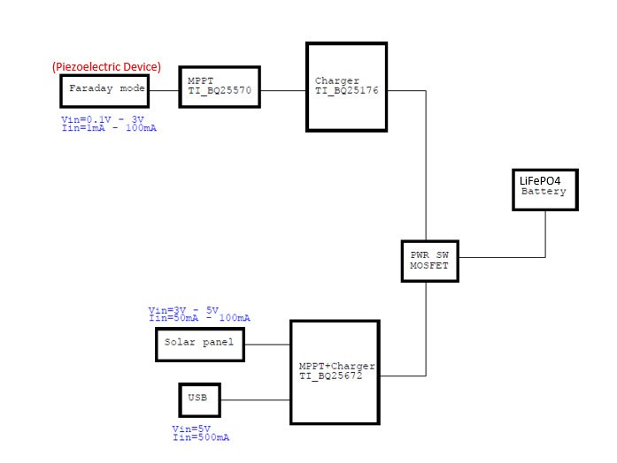

My customer will use a solar panel with 5V/0.2~0.3A(1~1.5W) to the BQ25672 power input.
They would like to confirm the minimum value of input current and charge current.
May I know if the minimum value of input current just supports 0.1A at 5V-in, right? the minimum value charge current is 0.01A at 5-Vin, right?

    You mean if the customer need to enable the MPPT function, the input current need 200mA at startup? How long is the startup time with 200mA?
    They would like to find a charge IC for a LiFePO4 battery(3.6V) and an input current of less than 100 or 200mA, may I know if there have any devices? Please advise us of the solution. Thanks!
  • Hi Henry,
    There is always a startup inrush current that is a function of the capacitance at PMID and SYS and the load on SYS.  The customer can limit the charger's input current to 100mA using the ILIM_HIZ pin resistors but the startup will be slower.
    If the solar panel open circuit voltage (VOC) is 5V then its VMPP ~=0.8*5V = 4.0V.  So any charger with VINDPM adjustable down to 4.0-V will work.  BQ25619 is another option.  In either case, charge must be disabled at power up using /CE pin because default charge voltage is 4.2V.  The host software then changes to the BATREG=3.6V and lowers VINDPM down to MPP threshold (~4.0V).

    May I know if the BQ25570 can or not support the LiFePO4 battery? if it can, I will ask the customer to remove the BQ25176.
  • Hi Henry,
    The BQ25570 output can be set to provide constant voltage of 3.6V for LiFePO4 using the VBAT_OV pin resistors.  BQ25570 does not provide constant current charging or termination current cutoff  like BQ25176.  If the piezo device could provide higher output power and therefore high charge current, I would recommend using the BQ25176 to provide constant current charging.  But since the piezo is relatively low power, using the BQ25570 to directly charge the battery is likely okay.
    can you provide more info (vendor, part number, rectification method, etc) for the piezo device?  We are currently spec'ing a new BQ255xx device and I would like more info on input sources.
    Jeff
  • Hi Sir,
    They used the ADI/ LTC3588-1 and the bridge rectification for the piezo device.
    BTW. the vout of piezo device is 20V, so the vin of BQ25570 can not meet their required, please also advise the suitable device. Thanks!
  • Hi Henry,
    The best option is BQ25570 with a zener diode clamp to 5.5V on VIN_DC however the clamp will steal current from Piezo so may not be practical. I do not see any other suitable device the BMS portfolio.
    Jeff
