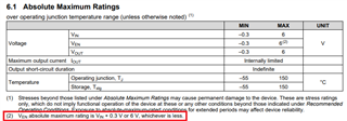

Our customer is using TLV70025DDCR.
Their using condition is as below.
* Condition
   VIN = 3.3V, VEN = 3.8V > VIN
* Data Sheet
If this device is under customer's using condition, could you please give me whether some issue will be happened or not?
Is there no issue?
Michael
  • Hi Michael,
    The abs max spec for VEN says that VEN cannot exceed VIN by more than 300mV, which implies that the limitation is due to an internal diode. So if VEN > VIN + 300mV, the diode will conduct and there is a potential for damage, so this is not a recommended use-case.
