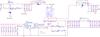

I am using the LM5164 IC for fly-buck converter.
Power supply parameters:
Input voltage: 30-60V from batteries
Main Output voltage: 3.3V, 0.3W
Secondary voltage 1: 12V, 1mA
Secondary voltage 2: 14V, 0.5mA
Switching frequency set: 75kHZ
The main transformer has 3 windings:
Primary: 100uH
Secondary 1: 1444uH
Secondary 2: 1849uH
The output voltage starts to decrease after 0.3W at the 3.3V output

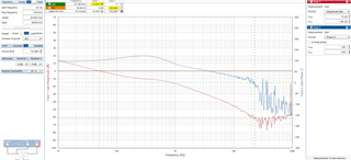

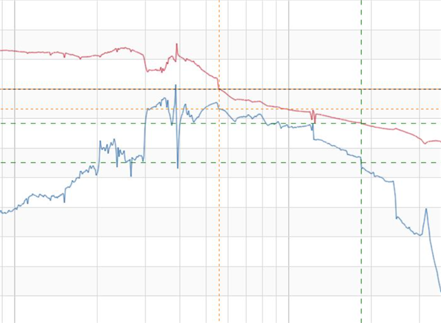

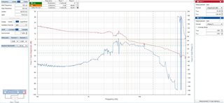

I am trying to test the stability using the bode 100 device, this is what I get for 30V, 0.3W:
SW voltage:
Output Voltage Rising:
From the SW voltage waveform it seems that the converter goes to sleep mode (this is what we want for light loads, because the supply is from batteries).
Because the converter goes to sleep mode, Is the bode plot result I see (in the first picture) is real? Is there a meaning to test the bode plot when the converter goes to sleep?
