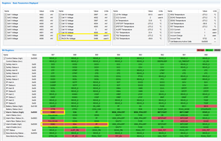

    Here is a printout from BqStudio showing the voltage drop (Stack vs. Pack) and some strange bits in the Alarm Status which don't appear to correspond with the actual SafetyStatus register values.  I confirmed these bit values are correct by sending independent commands to the device as well.

    I don't know that the gg.csv file is relevant in this case because the settings are reconfigured on startup.  The issue seems like a sequence of event problem..  I too was unable to recreate the issue using bqStudio alone (previous image was take after disconnecting from our host MCU and connecting to bqStudio).  The symptoms appear to line up with turning the DSG fet on during SLEEP.  However, in our setup, enabling the FETs after disabling SLEEP after a HWD alert seems to have the same effect.
    I have found a work around for the moment that is sufficient for my purposes.  In my application SLEEP is only enabled when we know the FETs will be off, so rather turning the DSG FET off satisfies our power requirements and there is no issue with a voltage drop after waking back up.
