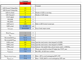

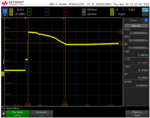

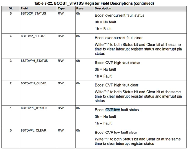

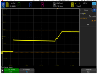

We find BSTOVPL_STATUS = '1'h when we power on the LP8864S-Q1. I think the reason is that boost converter reached out to VBOOST_OVPL in the beginning and let the BSTOVPL_STATUS bit pull high. And then boost converter stop switching to reach out our typical voltage setting. Now we are  trying to clear the error bit. We followed the datasheet to write [1:0] = '11'h, but useless. May you let me know your comment? Thank you.
