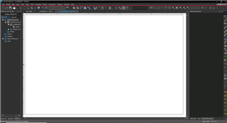

  • What I was referring to is when I installed PSpice for TI I assumed it would come preloaded with a number of TI parts already. However, when I click on PSpice Parts Search I have a completely blank window. The video on the TI website, the first instructional one, shows how you select the PSpice Parts Search and you should then see a whole host of TI parts to use in your simulation, but I see nothing. I opened a completely brand new project, named it as a PSpice simulation file, etc and this is what happened. What would you suggest I do to rectify this issue?
  • Hi Michael,
    Can you capture what you are seeing within PSPICE for TI? It should come loaded with all the TI devices.
    Also, what video are you referring to?
    Joseph
  • I just created this by New Project. When prompted I selected Blank new schematic. You can see the PSpice Parts Search window to the right.
  • Hi Michael,
    I haven't encountered this issue before.
    However, I have a couple suggestions:
    1) Can you try to reinstall the TI part models by going  (Help>"Reinstall TI Models and libraries") within PSPICE for TI
    2) If the first doesn't work, you can also try uninstalling PSPICE for TI and reinstalling.
    Joseph
  • I think I figured out my issue. I have OrCAD as my schematic editor and layout tool and so the PSpice for TI kind of defaults its logo to the same one for OrCAD and I think I opened an OrCAD file not a PSpice for TI file. When I did that I was able to see the parts.
