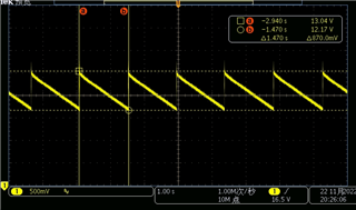

The figure below is the schematic design of LM5164 in customer application. The parameters basically refer to the demo board of this IC, but in the actual test process, the fluctuation range of the no-load output voltage waveform is too large.
It seems that after the FB pin voltage drops to 1.2V, the PWM start-up time is too long, and the output voltage rises more, resulting in a larger peak-to-peak value of the ripple, reaching 870mV.

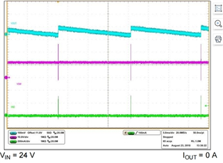

Compared with datasheet Figure25 . No-Load Switching waveform, the voltage ripple is much larger.

The output voltage waveform is as follows, each time the PWM starts, the output voltage will increase by about 870mV. At this time, the no-load input is 55V, and the output is 12V.
