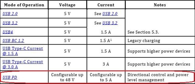

Team,
Is there device able to support up to 48V USB PD as show below? Very thanks.
Team,
Hi Brian,
Please refer to this FAQ thread regarding EPR capable device (up to 240W or 48V/5A): https://e2e.ti.com/support/interface-group/interface/f/interface-forum/1005232/faq-tps65987d-new-usb-type-c-pd-3-1-spec-enables-extended-power-range-up-to-240w-epr/4173681?tisearch=e2e-sitesearch&keymatch=epr#4173681
We are still developing our EPR solution for release and anticipating first half of 2023.
The TPS25750 is only capable of up to 100W (20V/5A) and is best suited for PD only applications (does not support DisplayPort, Alternate mode, Thunderbolt, etc.).
