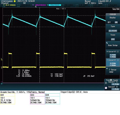

30V input, fsw=87kHz:
60V input, Fsw=93kHz:

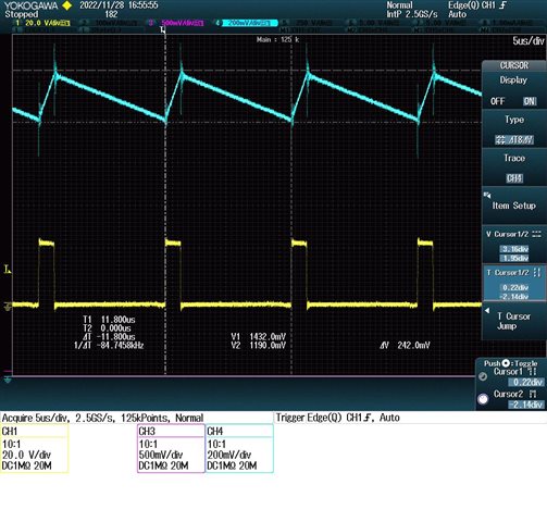

  • Hi Marshell,

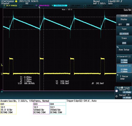

    I was wrong, when i change the input voltage the frequency is constant (but not 75k like i set it to), but when i change the load the frequency changes. Bigger load -> smaller frequency.
    Please take a look at the pictures:
    30V input, 10mW load:
    30V input, 500mW load:
    As you can see in the pictures of the 500mW, i don't think i get into sleep mode since i always have pulses and the FB voltage has constant slope (in sleep mode the FB voltage slope decreases)
    When i change the load to 1W or 1.5W, i get frequency of about 84kHz.
    Why i don't get the 75kHz? Is this an issue or its a normal operation?
    Thank you
  • Hello ,
    I do not think you are seeing anything irregular.
    I believe what you are seeing is that the equation for frequency calculation is not a perfect curve-fit.
    In that case, if you want to achieve right on the dot, 75kHz operation, I would advise increasing the RON resistance up to the next standard value ie: 118kOhm,

  • Hello Maor,
    Frequency should decrease with lighter loads.
    For the 1st 10mWout scope capture, the SW waveform doesn't appear to go discontinuous.
    For the quoted load current, that would not make sense to me as half the inductor ripple current would exceed the DC load current, so, in that case, the inductor current would go discontinuous which your waveform is not showing.
    With that said, I am unsure if I can make that same conclusion on your measurements.

    In my buck i have transformer with 2 more outputs, i disconnected the secondary diodes (left only with the primary winding), and in 10mW output power i get 1 and sometimes 2 pulses in 75kHz between them (like the formula) and than the IC goes to sleep for 1ms (When i connect the secondary's the frequency changes to 88kHz because the off time decreases because the secondary's take energy in off time and this influences the primary current).
    My questions are:
    1. Do you know why i get sometimes 2 pulses instead of always 1 pulse when the secondary's not connected (see the pictures below)? is it normal operation?
    Green - FB pin voltage (AC coupled)
    Red - primary current
    Yellow - SW pin voltage
    2. When i am working with 1W instead of 10mW (secondary's disconnected), the buck is working in CCM mode (see the current in the picture below) and the frequency raises to 85kHz (instead of 75kHz in 10mW), is it because the error in the formula?
    3. Why when i am increasing the load current i get bigger output voltage? 3.29V and 3.4V
    Is it normal operation?
    Thank you

    1. I meant that in 10mW i see 1 pulse and after 75kHz i see another and than the IC goes to sleep mode for 1ms. I dont see pulse and immediately after another pulse like in unstable operation, the design is stable. In 1W operation it is also stable since i see just 1 pulse in 85kHz and constant PWM (In figure 4 i see just 1 pulse).
    My question is: In 10mW load, i dont have to see just 1 pulse before the IC goes to sleep? Why i see 2 pulses in freq of 75kHz before the IC goes to sleep?
    2. What do you mean by jitter?
    3.its the main output. The leakage inductance is ~50nH.
    4. When i am working with 0.5W and in CCM mode, this is what i get in the bode plot:
    I get 50Hz cutoff frequency, is it ok or do i need to get higher cutoff frequency? The PM is 102 and the GM is 62. the PM is a correct result?
    Thank you
