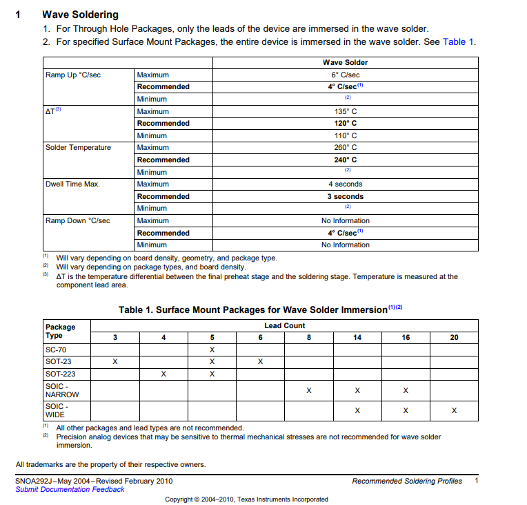

We need to complete welding of TLV73318PQDBVR next week.
Would mind providing me the SMT curve of SOT-23 and SOT583?
I just find the SMT of QFN, TSSOP, and SOIC on TI website.
Thanks for your support.
Hi Imelda,
We have the following app notes that could be used towards SOT packages:
QFN and SON PCB Attachment (Rev. B) (ti.com)
Recommended Soldering Profiles (Rev. J) (ti.com)
Wave Solder Exposure of SMT Packages (ti.com)
AN-2029 Handling and Process Recommendations (Rev. H)
The PCB design will also have some impact on the reflow profile.
