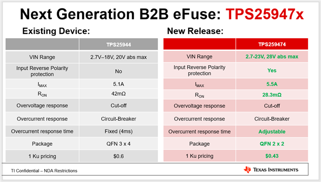

would you tell what are the main advantages and disadvantages between TPS25944A and TPS259474ARPW?

    Thanks for reaching out. Please see comparison below:
    Material
    TPS25940/2/4
    TPS25947x
    Max VIN (V)
    18
    23
    Abs Max VIN (V)
    20
    28
    Typ RON (mΩ)
    42
    28.3
    Min Current Limit (A)
    0.6
    0.5
    Max Current Limit (A)
    5.3
    6
    Current Limit Accuracy
    9%
    10%
    Analog IMON
    Yes (8%)
    Yes (15%)
    Bi-directional current
    No
    No
    Reverse Current Blocking
    Always
    Always (Linear Oring)
    Input Reverse Polarity Protection
    With external diode
    Integrated
    Max DC reverse Current(A)
    0.24
    0
    OC Fault Response
    ILIM/CB
    ILIM/CB
    OC Fault response time
    <100us for CL/
    Fixed 4ms for CB
    Adjustable
    Iq operating (uA)
    200
    428
    Isd (uA)
    15
    4.4
    UVLO
    Adj
    Adj
    OVP
    Adj OVLO
    Adj OVLO/Pin Sel OVC
    PG output
    Yes
    Yes
    Fault output
    Yes
    Yes
    Quick Output Discharge
    No
    No
    Package
    WQFN-20 , 3x4
    QFN, 2x2

    thank you for the info, Can you tell if the TPS2640 is also new gen of B2B  efuse?
    David.
  • Hi David,
    TPS2640 is for >40V rating and is similar architecture as TPS25940.
