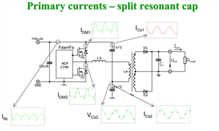

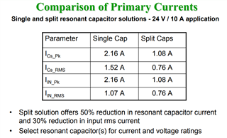

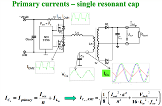

    1.
    If we understood correctly, the capacitors C1, C17 shown in document SLUUBX3B together make the total resonance capacitance. This placement of caps makes the converter looks like a standard half-bridge converter. What are the pros and cons of not placing them as in a standard Half-bridge LLC converter?
    Split resonant cap is advantageous compared to single resonant capacitor:
    For more details see the below screen shots:

    1.
    Regarding your reply to Q1, this split capacitor approach seems very interesting, what would be the level of stress voltage on power devices then? Could you please share more details/material for this approach? what tools did you use to make the comparison? it would be nice if these could be shared. Material can also be sent via email.
    The power devices stress wouldn't change with respect to resonant cap configuration (whether it's a single resonate cap or split resonant cap).
    In case of split cap configuration, resonant current is splitting between two parallel capacitors.
    I do not have any other material except those three pictures that I have shared previously for split cap advantages.

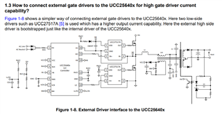

    6.
    What are your recommendations to drive power MOSFETs with this controller? In EVM-020, there is no external driver?
    For connecting external driver to the controller see the below screen shot:
