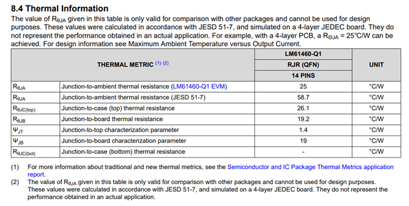

1.
The Thermal Information of LM61460-Q1 is like below.
The condition is 4 layer PCB.
Does the R value go down If it is 10 layer? Specific data. would be very helpful with
2.
What is the "Charaterization parameter" ?
